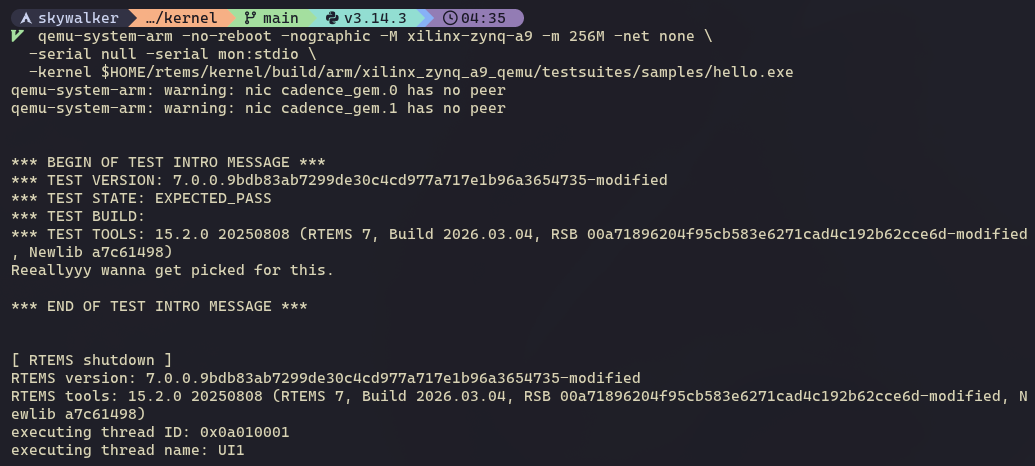

I just built RTEMS 7 from git, cross-compiled for arm/xilinx_zynq_a9_qemu, ran and modified the hello world sample on QEMU.
Tried to upload the patch file but it wouldn’t lemme so here’s a screenshot
