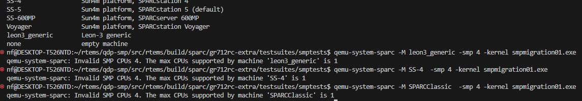

I’m research about rtems qdp smp V6 gr712, gr740 but, I wanted to test in an SMP environment with an emulator that supports RTEMS QDP SMP, but only one CPU core could be specified.
I used qemu-system-sparc on rtems/bin
Is it not possible to use more than 1 core?
I thought it might be because gr712 is dual core, so I tried it on gr740 and used the emulator on the rtems general distribution, but the same problem occurred.

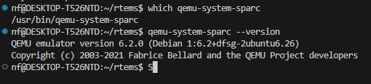

Can you please try a which qemu-system-sparc to find out which binary you are using and a qemu-system-sparc --version to find out the version?
Oh, it seems like the qemu path is not inside rtems. I tried sparc-rtems6-sis, but it only has one core, so I tried qemu, and it seems like the same problem occurred.
QEMU 6.2.1 is from 2021. Like I mentioned above, if I found the right patch above, SMP support for SPARC has been added 2024. So I think you need a newer QEMU. From the release history, I would expect that you need at least a version 9.0.0.
If your distribution doesn’t provide a current QEMU, you can just build one from the sources. Usually QEMU works quite stable in the development versions so I would just use the latest git version.
