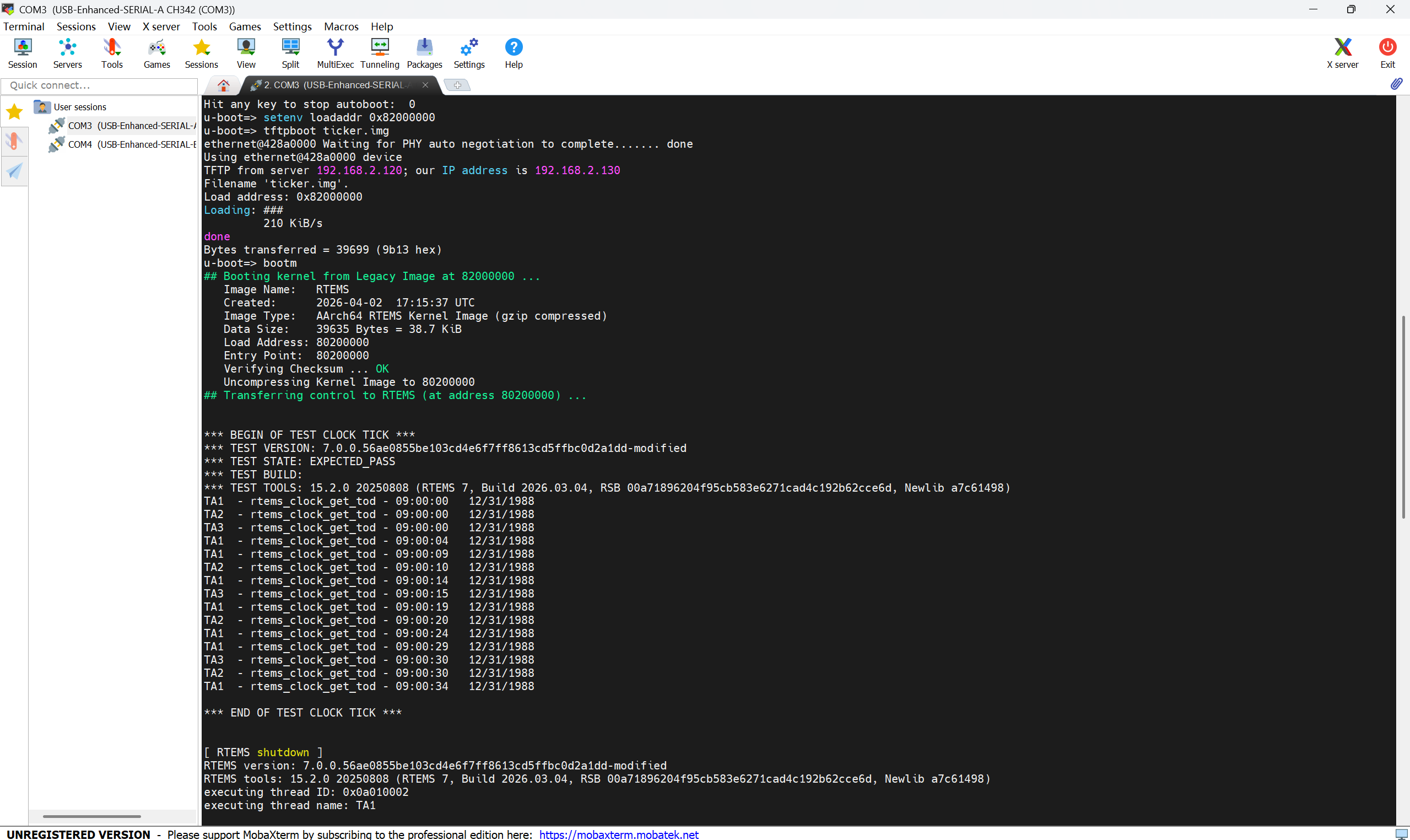

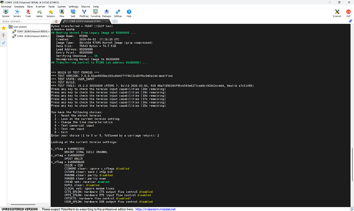

So I managed to port RTEMS 6.1 on FRDM-IMX93, both ticker and termios test looks good right now. Please welcome to check my repo on rtems gitlab: Corvo Lee / RTEMS61_IMX93 · GitLab

Thanks for the explanation. So I forked the lastest version and merged the imx93 bsp into it, after few modifications the compile passed and I validated the ticker and termios test, looks good to me.
