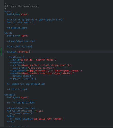

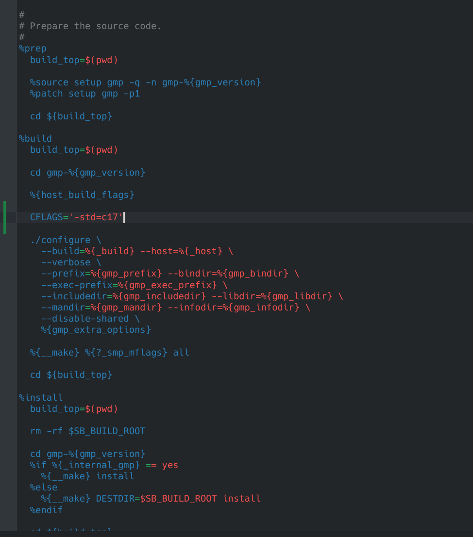

SOLVED! :smiley:
Adding CFLAGS='-std=c17' to gmp.cfg before invoking the configure script does the trick.
%build
  build_top=$(pwd)
  cd gmp-%{gmp_version}
  %{host_build_flags}
  CFLAGS='-std=c17'
  ./configure \
    --build=%{_build} --host=%{_host} \
    --verbose \
    --prefix=%{gmp_prefix} --bindir=%{gmp_bindir} \
    --exec-prefix=%{gmp_exec_prefix} \
    --includedir=%{gmp_includedir} --libdir=%{gmp_libdir} \
    --mandir=%{gmp_mandir} --infodir=%{gmp_infodir} \
    --disable-shared \
    %{gmp_extra_options}

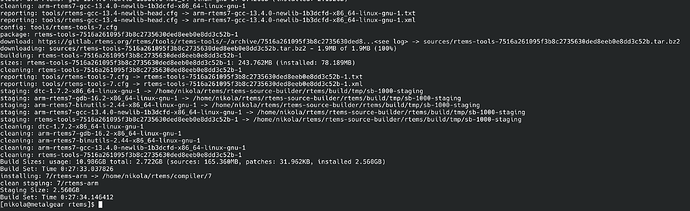

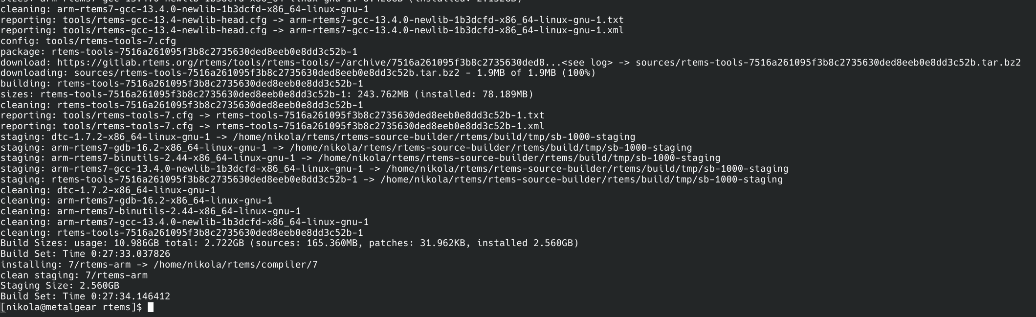

The tool suite is successfully building now.
Update:
Confirm mission accomplished.
