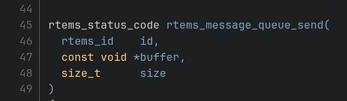

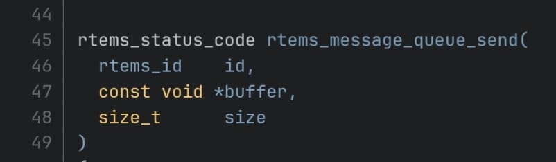

  • rtems_message_queue_send() calls _CORE_message_queue_Send() with wait = false Always.
  • That calls _CORE_message_queue_Submit(), but only the non-blocking path is used.
  • So Classic MQ send never seems to use the wait == true path.

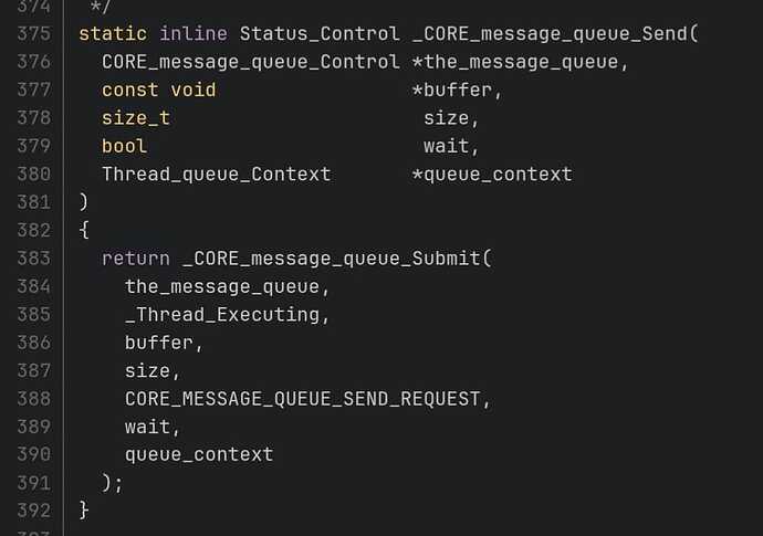

Looking at _CORE_message_queue_Submit(), it already supports:
  • Blocking send
  • Sender wait queues
  • Timeout handling via thread queue + watchdog
But this capability appears to be used only by POSIX MQs, not Classic MQs since Classic Mqs are always set to wait=false.

  1. Was the always non-blocking design of rtems_message_queue_send() an intentional Classic API choice for determinism and simplicity?

  2. Classic APIs go through _CORE_message_queue_Send() instead of calling _CORE_message_queue_Submit() directly like POSIX.
    Is this layering mainly for API abstraction?

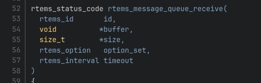

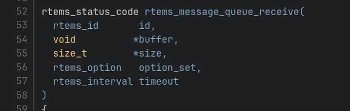

The Classic API message queue supports non-blocking, blocking forever, or blocking with timeout. The API pattern used it that the options argument must include RTEMS_NO_WAIT for polling. RTEMS_WAIT is the default and when in place, the timeout field is the number of ticks. Other Classic API objects like semaphores follow the same API pattern.
POSIX message queues support the sender being able to block when the queue is full and a message arrival notification. These are not in the Classic API message queues and disabled when POSIX is not enabled.

I think the Classic API message queue only waits on the receiver side though, not the sender side?

1st issue:- Classic send api blocking and timeout coverage gap :-
So the possible solution is coverage gap of classic send api , and my approach towards the solution is to create rtems_message_queue_timed_send( wait=true, timeout) and keeping the rtems_message_queue_send(wait=false) as it is for code modularity and differentiation.
And i clearly traced out that the in between _CORE_message_queue_send() is unnecessary since it directly calls the _CORE_message_queue_submit()
This solution makes sure that it follows the classic api pattern mentioned above.
Note:- classic receiver api clearly follows the api pattern, hence no changes required.

So if I understand correctly, in the Classic API, waiting semantics are intentionally supported only on the receive side, and send operations are designed to be non-blocking when the queue is full.
In that case, the wait+timeout path in _CORE_message_queue_Submit() is exercised primarily via the POSIX MQ APIs, and not through Classic MQ sends.
