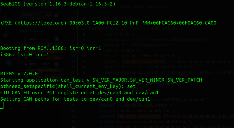

within the script. Then the error disappeared. But the terminal never came to the SHLL [/] # terminal as mentioned in here to test the CAN functionality. It just stuck as follows:
Even though I tried pressing enter, nothing happened.

Are you able to use the shell example from testsuites/samples? I would start by ensuring that is working.
The symptom of the problem is reported
pthread_setspecific(shell_current_env_key): set
The RTEMS shell (in the current versions) requires pthread_getspecific support which is dependent on the POSIX API feature compiled in.
So after you obtain default RTEMS configuration for i386_pc686 BSP
$RTEMS_DIR/waf bspdefaults --rtems-bsps=i386/pc686 -t "$RTEMS_DIR" -o "$MY_DIR" --prefix "/opt/rtems/7" >config.ini
You need to edit config.ini and enable RTEMS_POSIX_API by setting True, the whole line
# Enable support for POSIX signals, sporadic server and lio_listio()
RTEMS_POSIX_API = True
Then continue by regular build steps
$RTEMS_DIR/waf configure -t "$RTEMS_DIR" -o "$MY_DIR" --rtems-config "$MY_DIR/config.ini" --prefix "/opt/rtems/7" || exit 1
$RTEMS_DIR/waf || exit 1
$RTEMS_DIR/waf install || exit 1
Replace RTEMS_DIR and MY_DIR by appropriate paths.

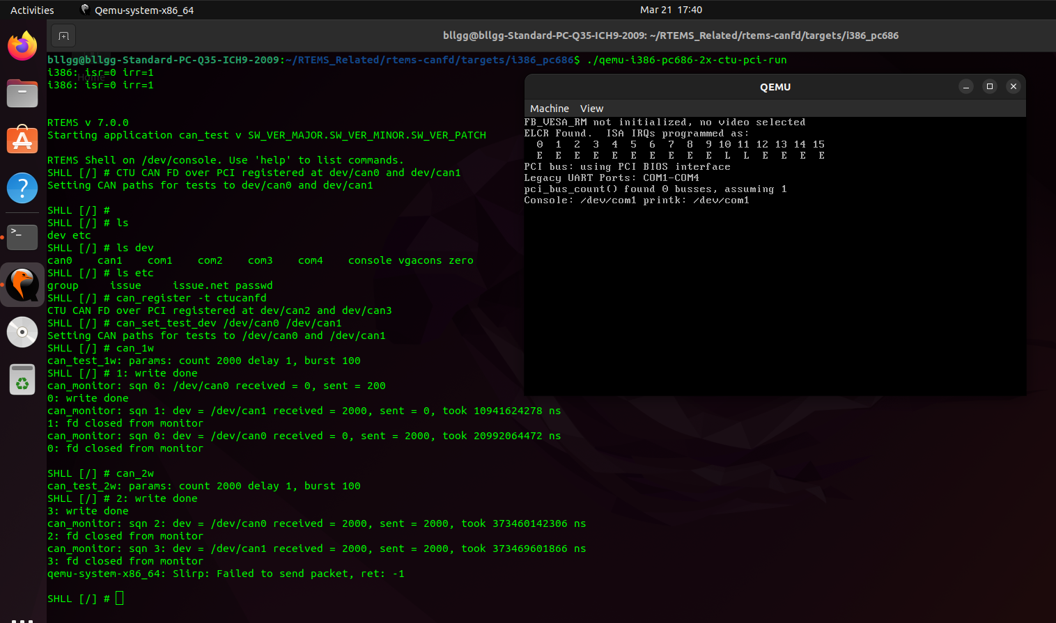

Thank you very much for the guidance. I was able to successfully run the tests mentioned in the RTEMS-CANFD in both the KVM-based Ubuntu VM and my physical computer.
