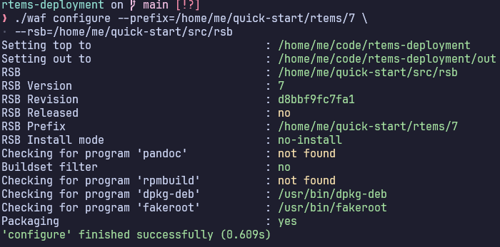

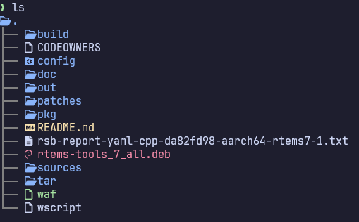

I have some initial success in generating debian control file and subsequently a .deb package.

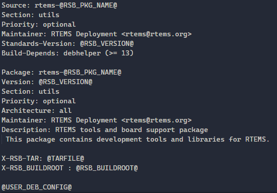

rpmspec file can contain commands which can be run at package build time. One being tar jxf %{rsb_tarfile} -C %{buildroot}. As far as I know control files cannot do that and would require the user to manually unpack the tar somewhere.
Is it acceptable behaviour?
I could use debain/rules and dpkg-buildpackage that would automatically extract the TAR specified in debian/control file in @TARFILE@ variable, but it would still be required to prepare deb_buildroot/ tree (ie. adding debian/rules, debian/control, debian/changelog, etc) manually via user. Should I make a helper python script that does all of it?

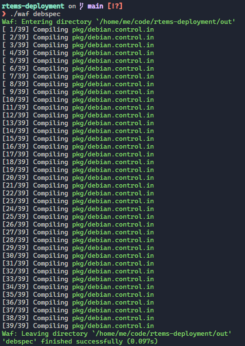

I have built the skeleton for the commandline utility rtems-pkg.
I plan on making it modular so that adding more packaging support is simpler. In the above image deb is one of the modules I made for it.

%define arch noarch
I have been looking into the existing packaging system and found this a bit odd. Why are we setting the package architecture to all in rpm.spec.in?
Shouldn’t it be amd64 or arm depending on for what architecture the toolchain was compiled for? Why are we doing this? Or did I miss something?
