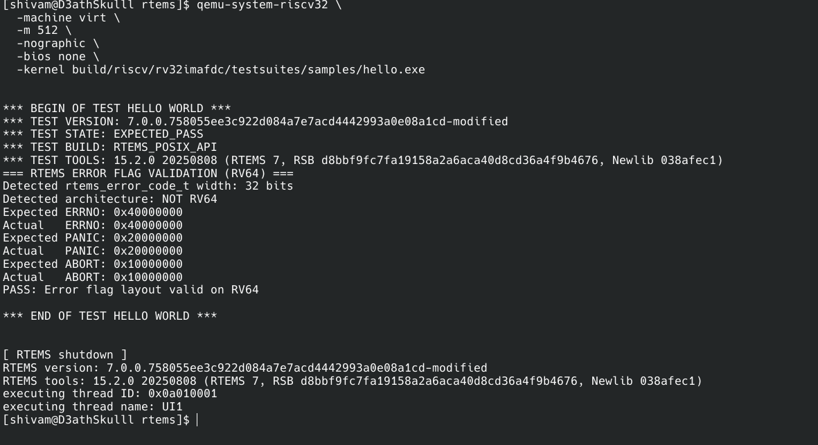

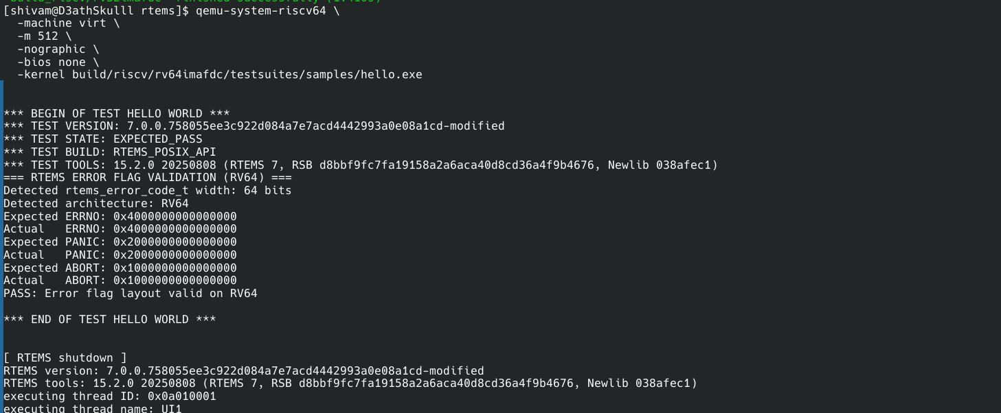

I ran the 64 bit and 32 bit RISC-V targets with qemu simulation.
[riscv/rv64imafdc]
[riscv/rv32imafdc]
The Aarch targets wern’t compiling the tests for some reason with or without my changes.
I had written custom tests to verify my changes in the hello test. Do you wish for me to create another test so one can verify it later?
Here for first image its a simple printf Issue from my end this is for rv32 only as you can view in the qemu system command from my side
