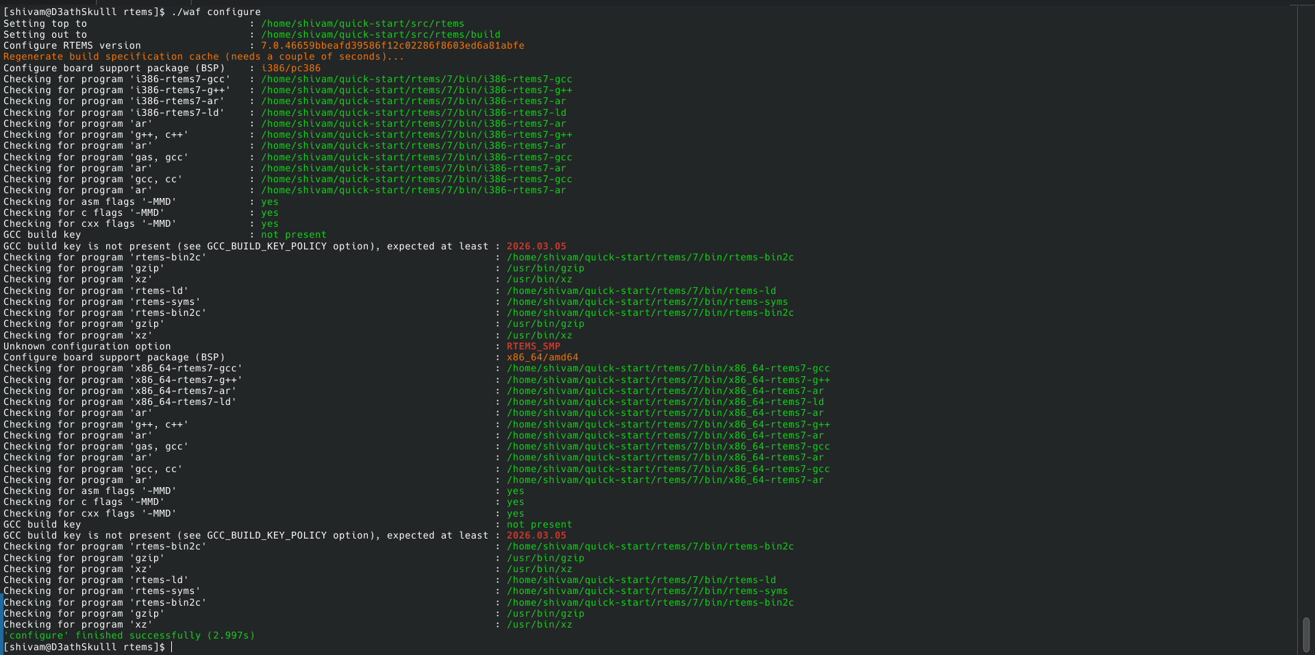

Error in testing SMP mode for pc386 and amd64 (and other bsps)
Facing Issue in RTEMS_SMP mode for solving and testing
Setting value of RTEMS_SMP doesnt seem to work as intended.
the parameter gets detected as unknown configuration option in the
./waf configure and on building using ./waf the bsp builds but the smp tests dont get created for the bsps.
Tried testing this on main and on my seperate branch.
Attached Output of ./waf configure and the config file used for testing

You are right. In RTEMS 7 RTEMS_SMP is missing from i386/pc386 (it is present for x86_64/amd64 and it is present in RTEMS 6):
cd rtems
git co main
./waf bspdefaults --rtems-bsps=i386/pc386 | fgrep RTEMS_SMP
Hm, the support was removed by commit 925405f3adf6e87c01c53a93c5ee16a8267eed06. See file spec/build/cpukit/optsmp.yml.
I think you should use the target i386/pc686 instead of i386/pc386. SMP support is present for the 686 target:
./waf bspdefaults --rtems-bsps=i386/pc686 | fgrep RTEMS_SMP

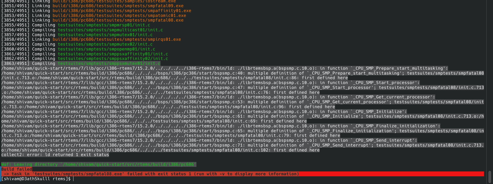

@gedare @frank_k
For the MR, smp tests are created for amd64 thats fine.
For the pc386 or pc686 (as of now), smptests were being created but architecturally this board is not smp based, rtems7 introduced spec based build so if the bsp is not smp based then waf gives error below.
What is the right course of action here?
The first issue, I think, this is just a misunderstanding.
Symmetric Multiprocessing (SMP) makes uses of several cores of a microprocessor. Consequently, enabling SMP makes only sense when a processor has several cores. If you do not enable RTEMS SMP for a multi-core processor then only one core is used while the other cores never run any code.
A pc368 denotes an Intel CPU from 1980s - the first 32 bit Intel processor, single core (the notion of multi-core systems did not even exists). These where used in the classical MS-DOS PC of that time (without graphical “Windows” user interface if I remember right). Therefore, RTEMS_SMP does not make any sense for pc386. That it was supported in RTEMS 6 is simply a mistake or bug.
A pc686 denotes a modern Intel multi-core CPU. If you sitting in front of a Laptop or PC with Intel or AMD CPU, that is a pc686. Here, RTEMS_SMP makes sense.
I do not know what you are up to, but if you do not use an extreme old PC/processor pc386 is probably not the BSP you want to use.
The linking error your are getting is a different issue. It should not happen.
The linker tries to link two similar or even identical files together:
  • testsuites/smptests/smpfatal08/init.c.713 and
  • testsuites/smptests/smpfatal08/init.c.76
I do not know how this can happen. One of them should not exist and not being part of the linking process. This is most likely a local bug in you worktree. Try to remove the build folder in the rtems repo and re-run ./waf configure [...] and then ./waf. If you have installed rtems before (./waf install) the you may even need to get rid of the installed rtems to avoid it gets part of the linking.
