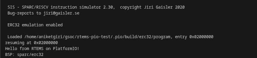

I’ve built a working prototype: Aniket Giri / platform-rtems · GitLab
It uses pkg-config to dynamically extract all BSP flags zero hardcoding. pio run successfully compiles and links an RTEMS hello world for sparc/erc32, and the built ELF runs correctly on SIS.
Yes, this is a good baseline to start from. You should be able to use this to explore some of the questions you’ve raised already and to shape your proposal. You’ll want to show these capabilities as part of your proposal.

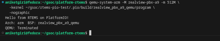

Hi @gedare,
I wanted to share an update on Issue #78 following your suggestion to validate beyond SPARC.
I added support for the ARM BSP arm/realview_pbx_a9_qemu and verified that the existing framework abstraction works without modification.
What was validated:
  • Built RTEMS 7 ARM toolchain (rtems-arm)
  • Built and installed realview_pbx_a9_qemu BSP
  • Added boards/realview_pbx_a9_qemu.json with:
“rtems_arch”: “arm”,
“rtems_bsp”: “realview_pbx_a9_qemu”
  • No changes required in builder/frameworks/rtems.py
  • Toolchain prefix derived dynamically (arm-rtems7)
  • pkg-config package derived dynamically (arm-rtems7-realview_pbx_a9_qemu)
  • Compiler and linker flags injected automatically
End-to-end validation:
  • pio run builds using arm-rtems7-gcc
  • Binary executes under QEMU:
The design now works across:
  • SPARC (sparc/erc32 via SIS)
  • ARM (realview_pbx_a9_qemu via QEMU)
All configuration remains fully data-driven via board JSON + pkg-config, with no BSP-specific flags hardcoded.
