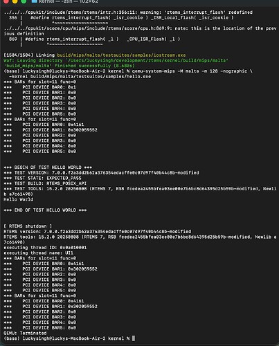

I’ve been working on setting up the environment for the MIPS Malta SMP project and wanted to share some progress.

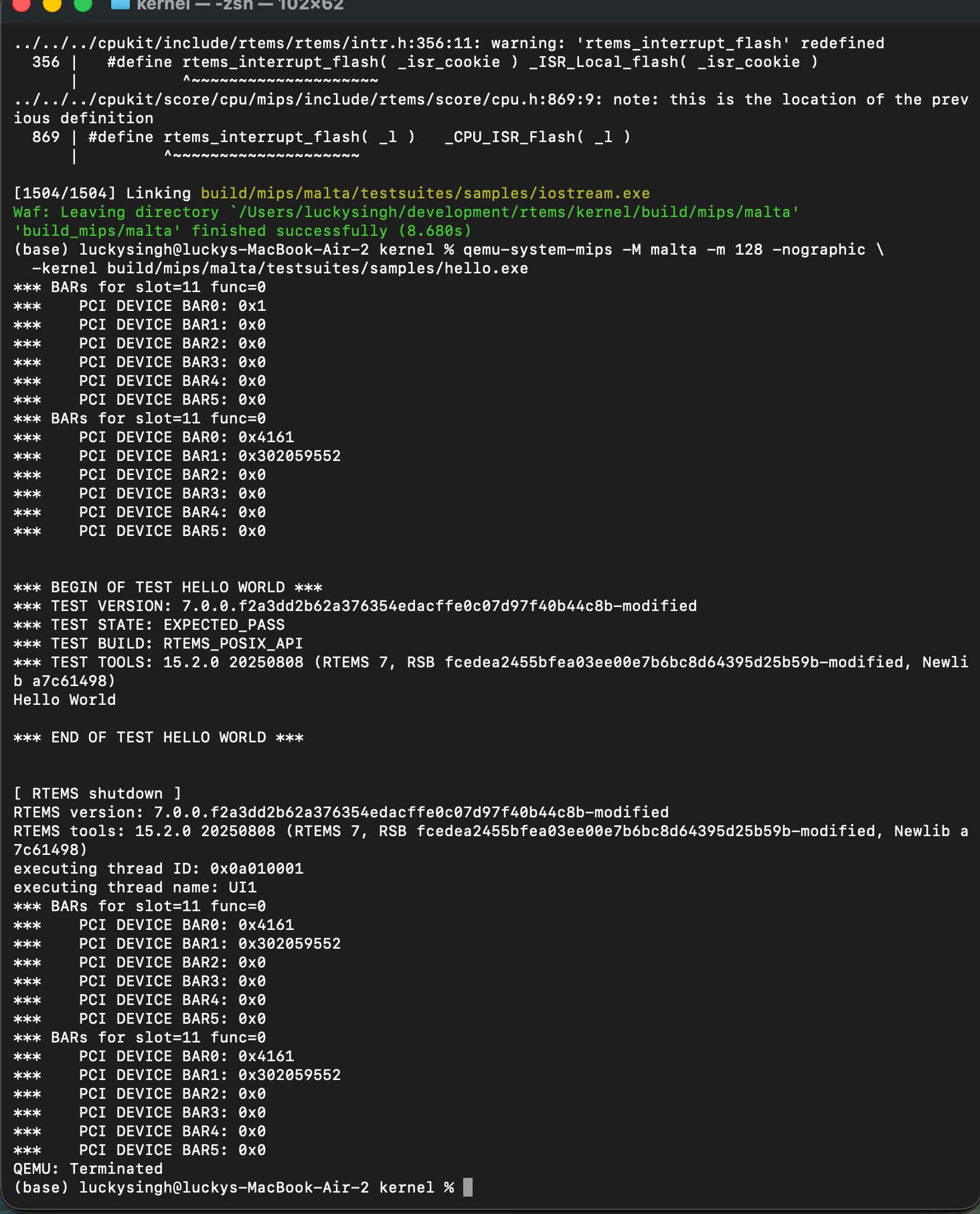

I first Successfully built and configured the mips-rtems7 toolchain on my macOS. After resolving some header conflicts in RTEMS 7, I managed to successfully build the kernel (1504/1504 tasks). I have successfully booted the hello.exe sample on the Malta BSP using QEMU.
I identified a conflict between cpukit/score/cpu/mips/include/rtems/score/cpu.h and generic RTEMS headers regarding interrupt macros. I’ve temporarily bypassed this with -Wno-error but am preparing a proper #ifndef patch to fix this upstream.
The default BSP was crashing due to uninitialized TLB mapping for USEG memory. I modify the linker script to shift the RAM ORIGIN to 0x80000000 (KSEG0/Unmapped Physical). This confirmed that the core kernel and serial drivers are functional.
Solution of Header conflict bug.

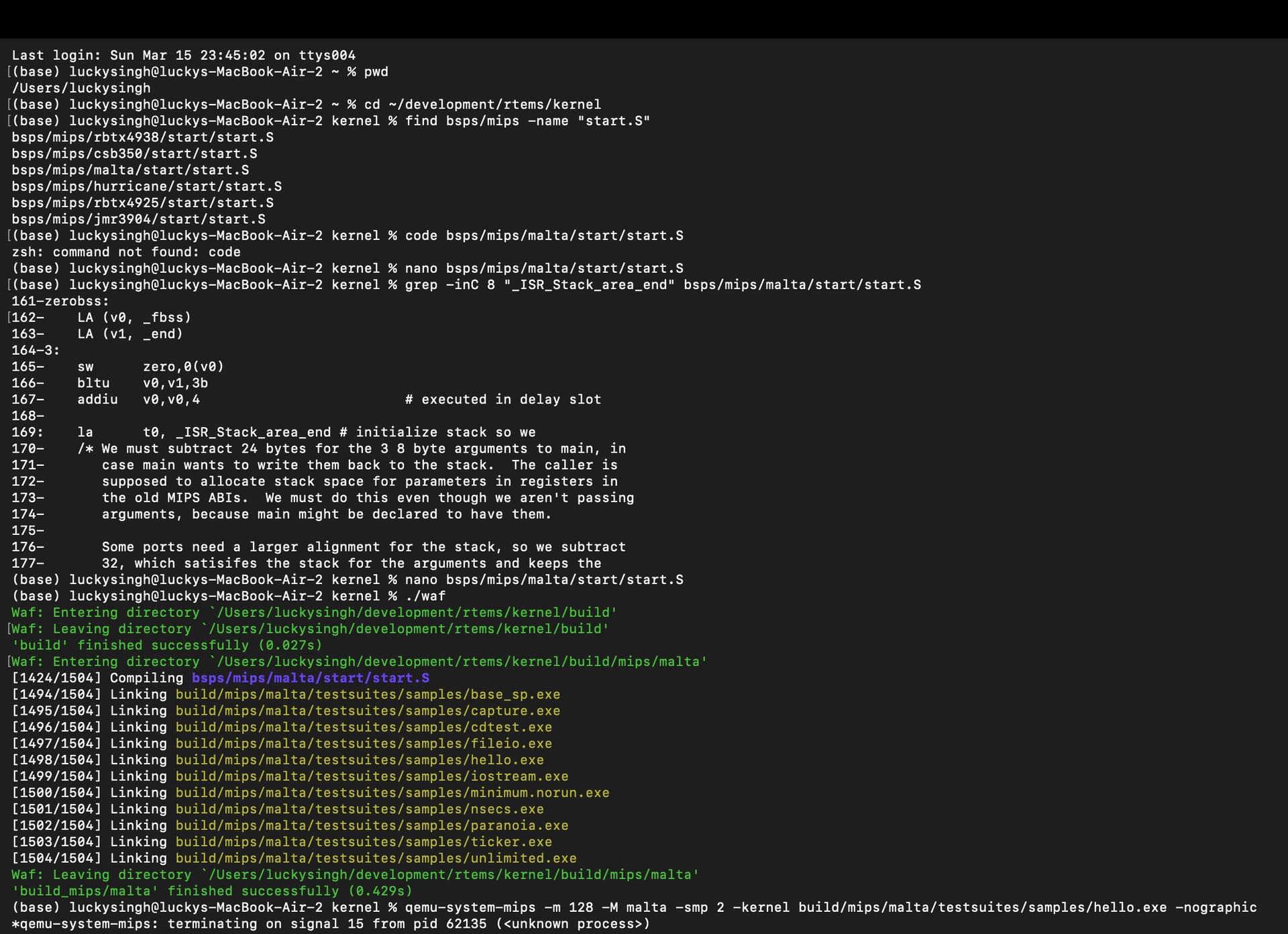

I first updated the spinlock logic in cpu.c to use native MIPS ll/sc (Load Linked / Store Conditional) instructions. This was necessary to properly handle atomic exchanges and resolve C11 _Atomic type mismatches. then I cleaned up cpuimpl.h by removing redundant function declarations. This resolved the “multiple definition” linker errors that were previously creating errors in the build process. After that I implemented logic to read the CP0 EBase register (Register 15, Select 1) to accurately identify the CPU ID (Core 0 vs Core 1) at the very start of the boot process. I added a branch to ensure that only the primary processor (Core 0) executes the .bss zeroing loop. This prevents race conditions where both cores might attempt to clear memory simultaneously. Based on the CPU ID, I implemented a stack offset calculation. Each core now calculates its unique stack area starting from _ISR_Stack_area_end, ensuring that Core 0 and Core 1 have completely isolated stacks. I added a secondary_park loop using a wait instruction. This “parks” the secondary core in an idle state, allowing Core 0 to proceed to boot_card without interference.

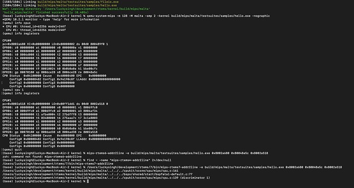

Now for validating and debugging I used qemu
The kernel now builds successfully
I verified the implementation (-smp 2) using the monitor to inspect registers.
Using addr2line, I confirmed that both cores have successfully entered the C environment:
Core 0 reached bspfatal-default.c:77 (Fatal halt at cpu.c:161), which confirms the primary boot path is active. Core 1 is successfully isolated at cpu.c:139, confirming the assembly-level branching and parking logic works.
