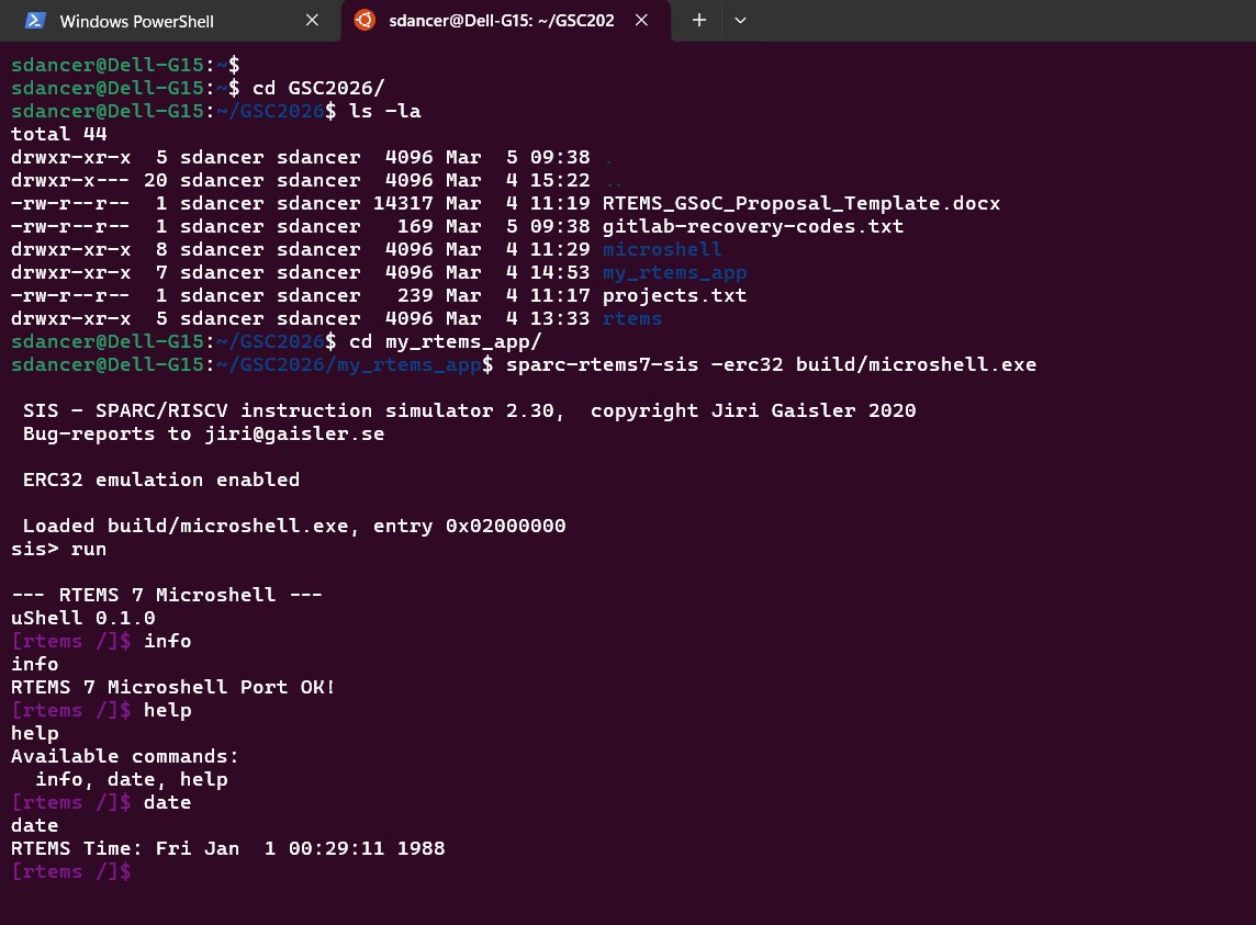

Environment
Host OS: WSL2 under Windows 11
RTEMS Version: RTEMS 7
BSP: SPARC
Execution: A basic implementation of the microshell port
#include <time.h>
#include "ush.h"
#define BUF_SIZE 64
static char ush_in_buf[BUF_SIZE];
static char ush_out_buf[BUF_SIZE];
struct ush_node_object ush_root_node;
void help_callback(struct ush_object *self, struct ush_file_descriptor const *file, int argc, char *argv[]) {
    printf("Available commands:\n  info, date, help\n");
void date_callback(struct ush_object *self, struct ush_file_descriptor const *file, int argc, char *argv[]) {
    time_t now = time(NULL);
    printf("RTEMS Time: %s", ctime(&now));
void info_callback(struct ush_object *self, struct ush_file_descriptor const *file, int argc, char *argv[]) {
    printf("RTEMS 7 Microshell Port OK!\n");
const struct ush_file_descriptor g_ush_buildin_commands[] = {
    { .name = "info", .help = "info", .exec = info_callback },
    { .name = "help", .help = "help", .exec = help_callback },
    { .name = "date", .help = "date", .exec = date_callback },
    { .name = NULL }
const size_t g_ush_buildin_commands_num = 3;
int msh_write_char(struct ush_object *self, char c) { return putchar(c); }
int msh_read_char(struct ush_object *self, char *c) {
    int ch = getchar();
    if (ch != EOF) { *c = (char)ch; return 1; }
    return 0;
static const struct ush_io_interface msh_iface = {
    .read = msh_read_char,
    .write = msh_write_char
static const struct ush_descriptor msh_desc = {
    .io = &msh_iface,
    .input_buffer = ush_in_buf,
    .input_buffer_size = BUF_SIZE,
    .output_buffer = ush_out_buf,
    .output_buffer_size = BUF_SIZE,
    .hostname = "rtems"
rtems_task Init(rtems_task_argument argument) {
    static struct ush_object ush;
    printf("\n--- RTEMS 7 Microshell ---\n");
    ush_init(&ush, &msh_desc);
    ush_node_mount(&ush, "/", &ush_root_node, NULL, 0);
    ush.current_node = &ush_root_node;
    while (1) {
        ush_service(&ush);
        rtems_task_wake_after(1);
#define CONFIGURE_APPLICATION_NEEDS_CONSOLE_DRIVER
#define CONFIGURE_APPLICATION_NEEDS_CLOCK_DRIVER
#define CONFIGURE_MAXIMUM_TASKS 4
#define CONFIGURE_RTEMS_INIT_TASKS_TABLE
#define CONFIGURE_INIT
#include <rtems/confdefs.h>

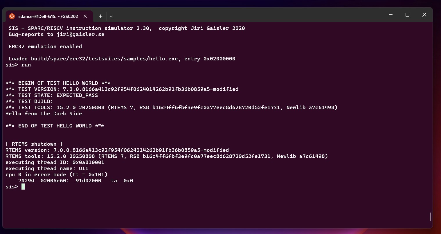

Please send your hello world patch as described in 2.9. GSoC Getting Started — RTEMS User Manual 7.1023b8c (8th January 2026) documentation
Done!
sdancer@Dell-G15:~/GSC2026/rtems$ cat 0001-Modified-hello-world-message-for-GSC2026.patch
From aa1bfd07fb3776b795363997753161927e43ea37 Mon Sep 17 00:00:00 2001
From: Olympia Papaioannou <papaioannou.olia@gmail.com>
Date: Fri, 6 Mar 2026 12:20:50 +0200
Subject: [PATCH] Modified hello world message for GSC2026
 testsuites/samples/hello/init.c | 2 +-
 1 file changed, 1 insertion(+), 1 deletion(-)
diff --git a/testsuites/samples/hello/init.c b/testsuites/samples/hello/init.c
index 76b939818a..52ff966073 100644
--- a/testsuites/samples/hello/init.c
+++ b/testsuites/samples/hello/init.c
@@ -41,7 +41,7 @@ static rtems_task Init( rtems_task_argument ignored )
   rtems_print_printer_fprintf_putc( &rtems_test_printer );
   TEST_BEGIN();
-  printf( "Hello World\n" );
+  printf( "Hello from the Dark Side\n" );
   TEST_END();
   rtems_test_exit( 0 );
2.43.0
