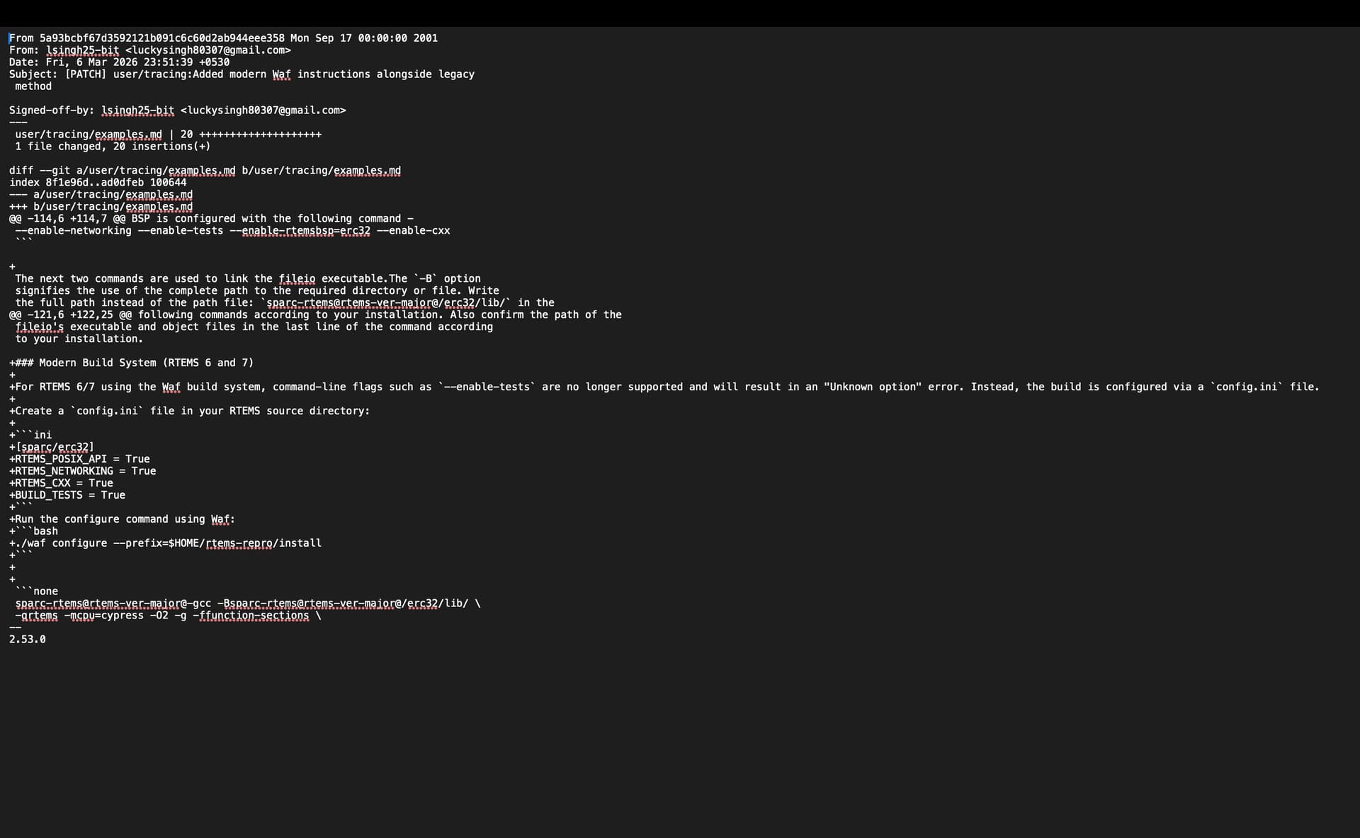

I have successfully set up the RTEMS 7 kernel environment on my macOS . During this process, I noticed that the user/tracing/examples.md documentation still references legacy Autotools configuration flags ( --enable-tests), which lead to “Unknown option” errors in newer versions.
I have prepared a patch that adds the modern Waf build system and config.ini instructions alongside the legacy methods to help future users. Since I cannot attach .patch files directly here, I have hosted it as a Gist . I’d appreciate it if someone could review it!

Thanks and welcome, can you please attach a picture of your patch?
Sure, here is the picture of that, apart from that I have also pulled for a merge request for the same.
Thanks for your consideration.
Thank you. It looks like your git config user.name may not be correct, please double check. after you fix that, you can update your MR and also add yourself to tracking/2026 · main · RTEMS / Programs / Google Summer of Code · GitLab.
