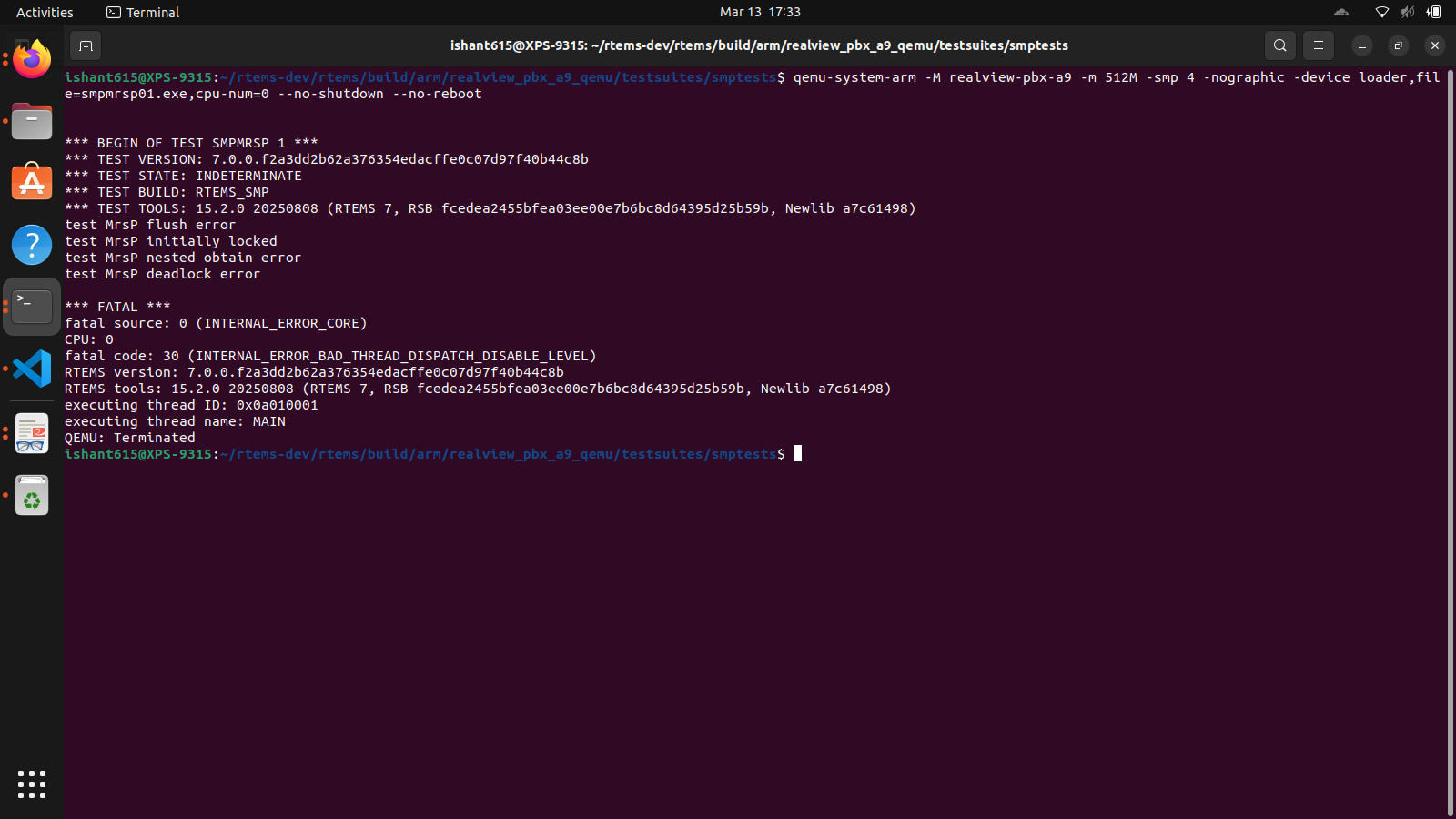

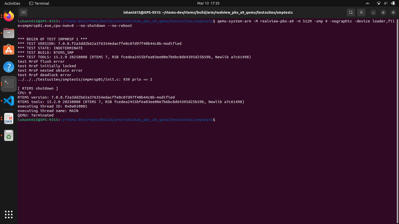

Initially the task was running into FATAL error in the test_mrsp_deadlock_error(ctx) function (1st screenshot attached), when the priority of the main task and worker task were both prio = 2. On changing the priority to prio = 4, the test moved ahead but then failed the assertion rtems_test_assert( prio == 2 ) causing RTEMS shutdown (2nd screenshot attached).

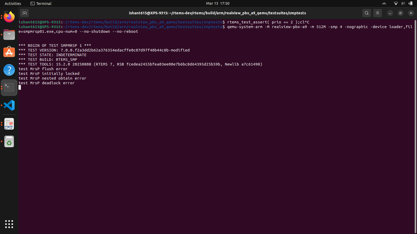

On changing the priority to prio = 1, the task stalled infinitely (3rd screenshot attached) because another task created inside the function had the same priority.

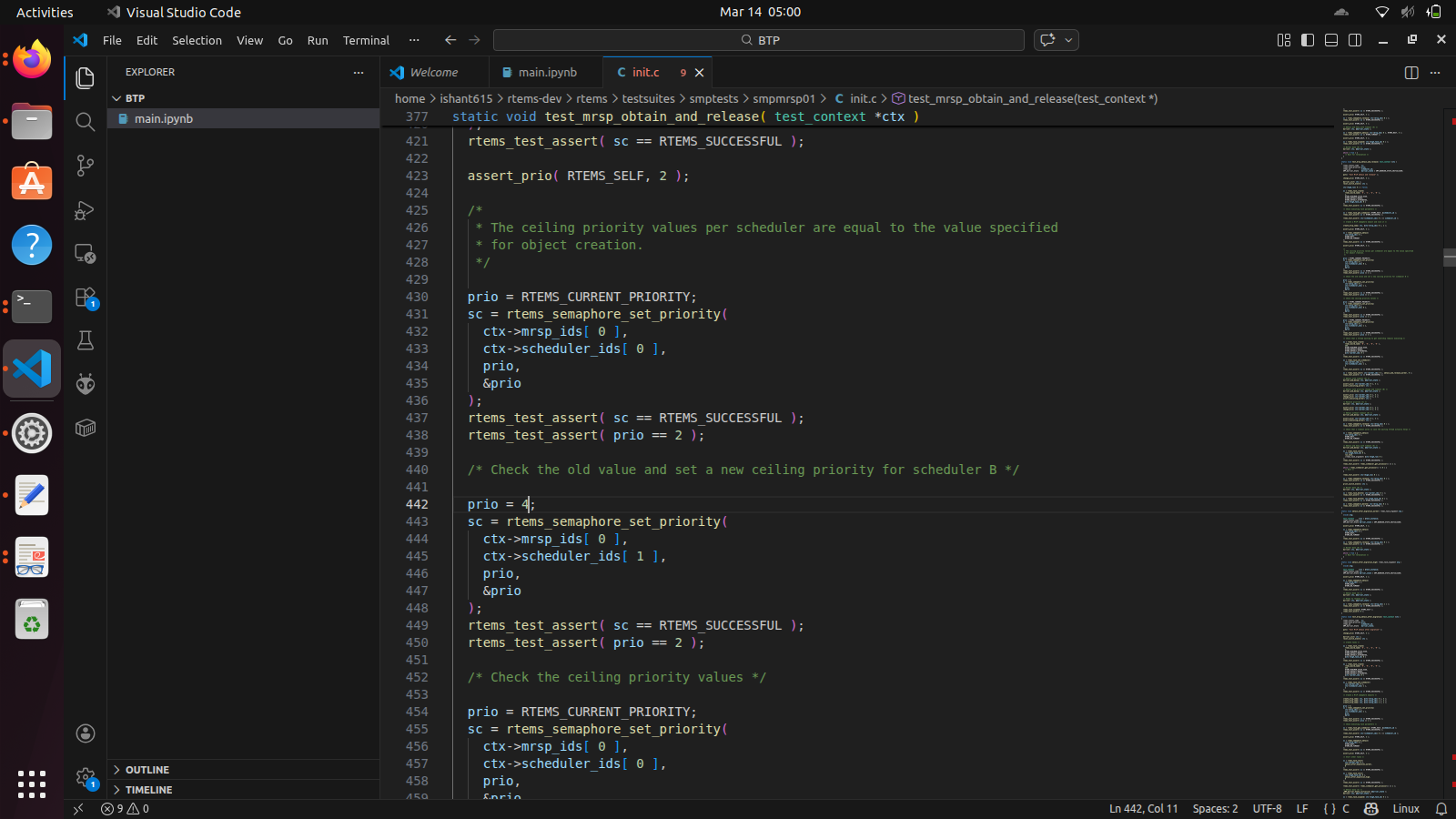

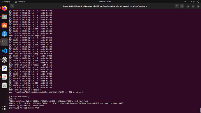

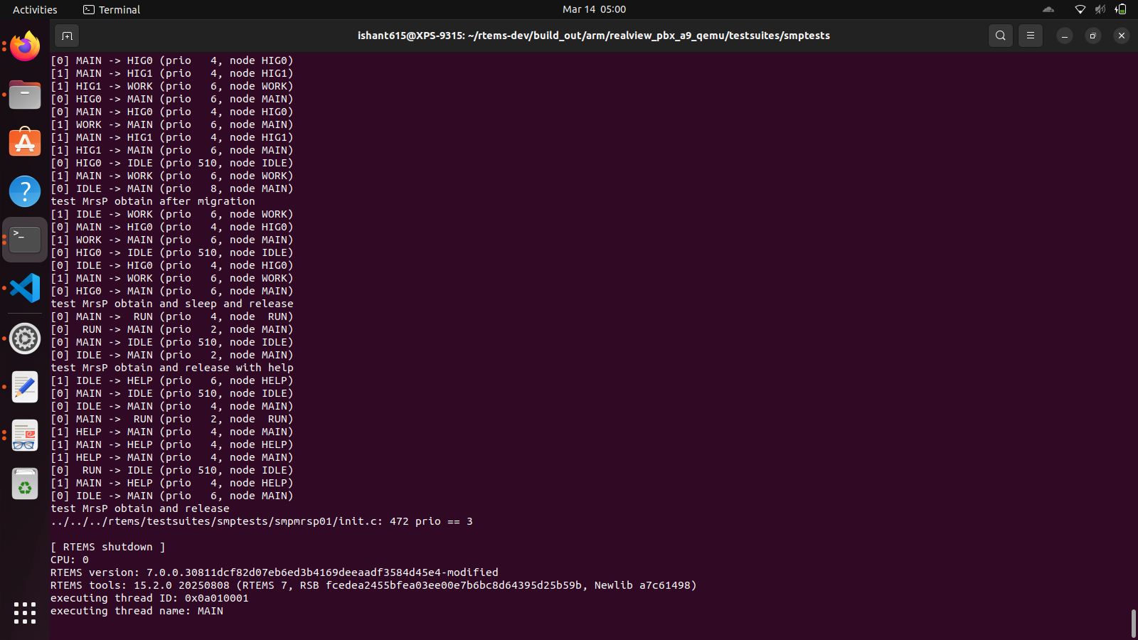

I made some small changes in the init.c file for testing purposes, like changed the priority of one of the tasks (screenshot attached). This caused the task to fail its own assertion (screenshot attached).
