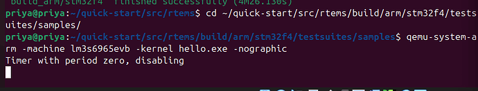

I find out that for rtems we have use QEMU for testing … I rechecked the builds and found no erorrs as its showing everything correclty but when I start testing my hello.exe file with the command
qemu-system-arm -machine lm3s6965evb -kernel hello.exe -nographic … its prints the disabling statement of period zero and then keeps going on for more than 30 mins… and i guess that’s not normal…
please help…
have look
If you want to use qemu, it can be built with its own bare metal RSB recipe or if your host comes with a suitable package you can just install qemu from there.
STM32 projects are expected to run on the hardware directly though. Part of developing a proposal for such a project would include showing that you can run the BSP on the board.
