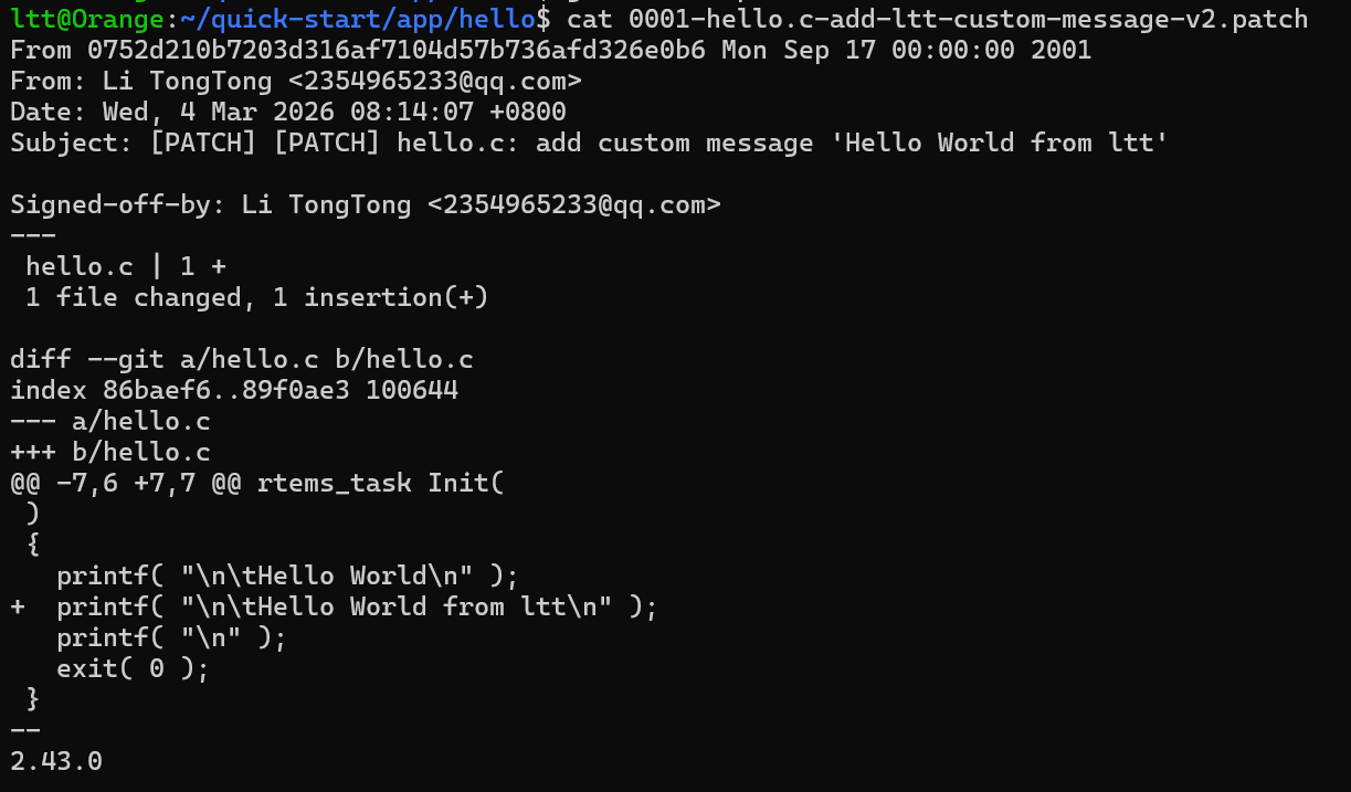

I modified the core logic file hello.c in my RTEMS hello world project, adding a custom print message while keeping the original “Hello World” output for comparison. The change is simple: I added printf("\n\tHello World from ltt\n"); after the original print statement.

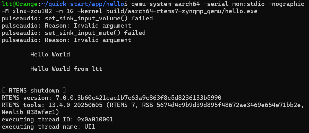

I built the project with the RTEMS 7 aarch64 toolchain and ran it on QEMU (zynqmp_qemu BSP) using the command:
qemu-system-aarch64 -serial mon:stdio -nographic -M xlnx-zcu102 -m 1G -kernel build/aarch64-rtems7-zynqmp_qemu/hello.exe
The program ran successfully, outputting both the original “Hello World” and my custom message (screenshot attached below). I also generated a Git patch for this modification to make it easy to review.

Thanks, it looks like your git config user.name may not be correct, please check that it matches your name for author attribution.

Thanks for checking! I’ve fixed my git config user.name to use my full name Li TongTong and updated the patch in the main post. I’ll now add myself to the tracking/2026 list as you suggested.
