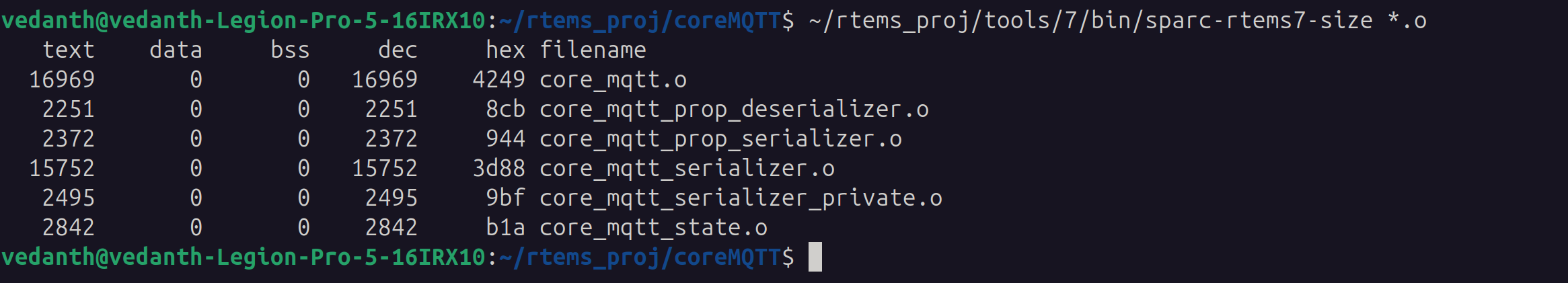

  5. coreMQTT cross-compiled for sparc/leon3 with -Os optimization. Total .text footprint across all 6 source files: ~42 KB.

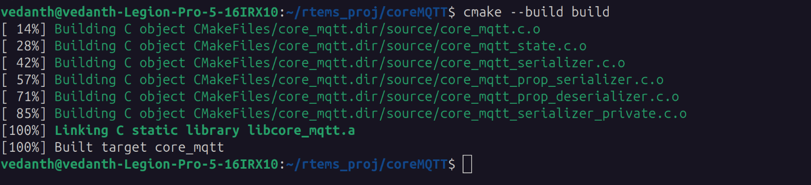

    • Can you build the software at all?
Was able to build coreMQTT with standard gcc with cmake on linux ( more specifically ubuntu 24 )with minimal platform config file.
Minimum dependencies (no threading , no malloc , no networking dependencies)

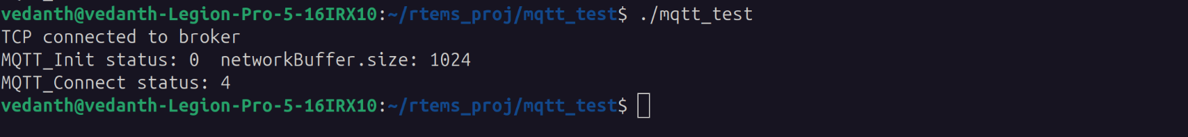

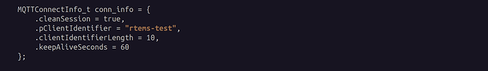

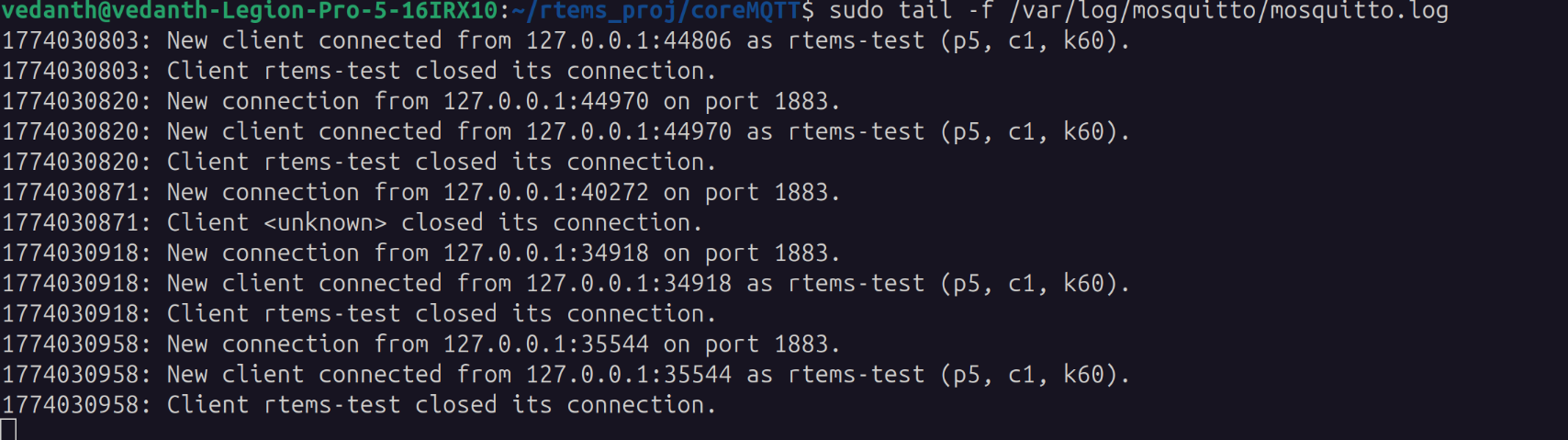

    • Can you run the software on anything?
TCP transport works. Broker log shows the client connecting as rtems-test with MQTTv5 protocol, clean session, keepalive 60 which matches the MQTTConnectInfo_t config. MQTT_Init returns 0 (success). MQTT_Connect returns status 4 MQTTSendFailed, likely because the nonblocking recv fires before the broker’s CONNACK comes back. The broker accepted the connection so the issue is on the client side socket configuration, not coreMQTT itself.

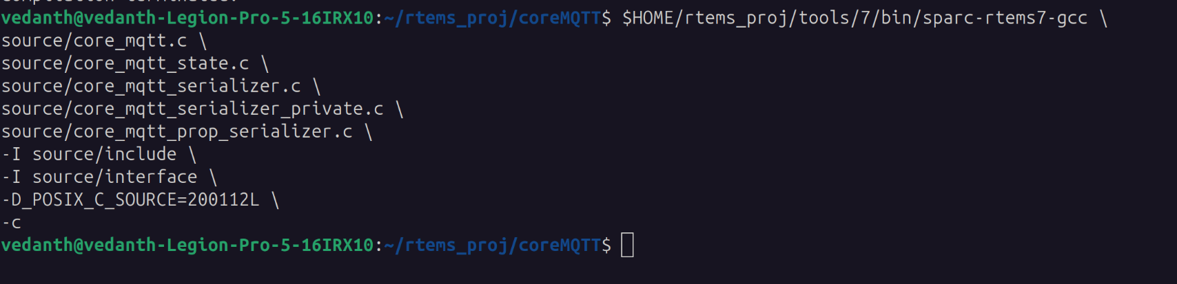

    • Can you build the software with RTEMS?
Cross-compiled all coreMQTT source files with sparc-rtems7-gcc targeting the leon3 BSP. Clean compilation with no errors or warnings, only requires -I source/include, -I source/interface, and -D_POSIX_C_SOURCE=200112L. No RTEMS-specific modifications to the coreMQTT source were needed.

  • coreMQTT has 6 source files and no external dependencies as seen from the images.
