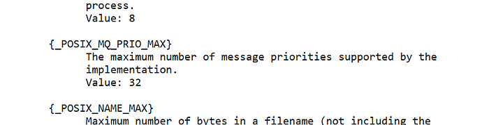

  4. POSIX limits.h view showing _POSIX_MQ_PRIO_MAX = 32:
    limits.h(0p) - Linux manual page
This confirms that the fixed limit is inserted by the toolchain during compilation and aligns strictly with POSIX standards.

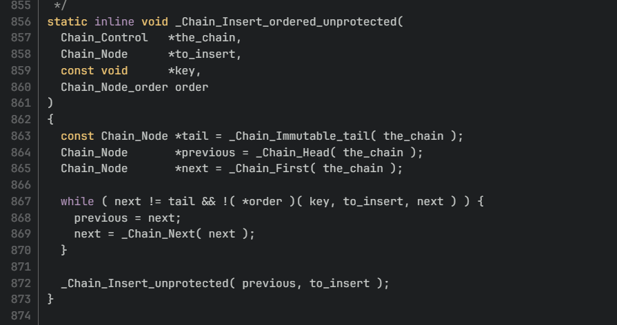

From there, I traced the current O(n) linear scan bottleneck caused by the ordered chain insertion in coremsginsert.c.
its in chainimpl.h
The while loop is iterating to every node, making it O(n).

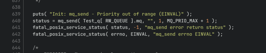

I also took time to verify the existing test cases. Initially, I planned to write a separate test file (psxmsgq05) to validate these boundaries. However, after reviewing psxmsgq01, I realized it already covers these scenarios. I ran psxmsgq01 locally and verified it successfully checks all edge cases:
  1. Priorities > MQ_PRIO_MAX are correctly rejected.
  2. Inter-priority insertion (Strict priority ordering, which is currently O(n)).
  3. Intra-priority insertion (FIFO ordering for messages with the exact same priority).
