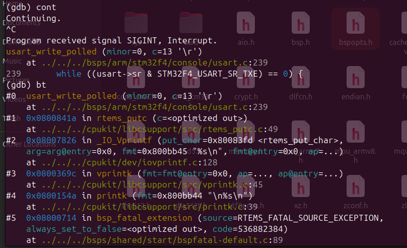

Thankyou ! i tried this method before and now i found that i typed same thing with wrong arguments. i rebuild it after doing the changes but now it is getting stuck at usart.c
i am getting this in the gdb console.
The backtrace reveals that you’re hitting two separate walls.
First, look at Frame #5: you have an RTEMS_FATAL_SOURCE_EXCEPTION. Your code actually crashed before it ever reached the UART loop.
Second, the hang at usart.c:239 is happening because RTEMS is trying to print that fatal error to the console. Since it’s stuck there, it means your USART1 hardware isn’t ‘live’—the TXE flag isn’t updating because the peripheral clock probably isn’t enabled in the RCC or the GPIO pins aren’t muxed to USART1.
You’ll need to fix the hardware clocking just to see the error message that explains why you crashed in the first place.

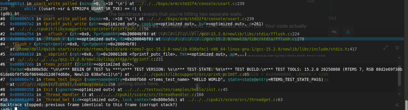

i check the GPIO are enable but the clock peripheral is not getting enable. i don’t know what is wrong.
i try to check by print usart and got this.
p usart
$10 = (volatile stm32f4_usart *) 0xcab9374f
i set it to:
set usart = 0x40004400
and
cont
it print in the console and again usart set back to the (volatile stm32f4_usart *) 0xcab9374f.
why it is happening?
It looks like the usart pointer is loading a garbage address (0xcab9374f) instead of the actual peripheral base. This is likely why the clock peripheral isn’t enabling, the code is writing to an invalid memory location.
A few things to check:
  1. Re-run Configure: After editing config.ini, did you run ./waf configure before ./waf build? If not, the changes won’t apply.
  2. Check Indexing: In usart.c, check how the minor number maps to the usart pointer. If you enabled USART_2 but the BSP defaults to a different index, it might be accessing an out-of-bounds array element.
  3. Map File: Check your build’s .map file for the address of the USART configuration table to see where that junk value is coming from.
Since this happened on both F401RE and F446RE, it’s definitely a configuration/build issue rather than hardware.
Since you’re still seeing that 0xcab9374f address, try these GDB commands to find the source:
  1. watch usart: Run this before the crash. GDB will stop the moment that pointer gets overwritten with the garbage value.
  2. info symbol 0xcab9374f: This will tell us if that ‘address’ is actually a piece of code or a specific variable that is being misinterpreted as a pointer.
Also, double-check your config.ini. If you have both USART_2 and USART_3 enabled at the same time, ensure only one is designated as the console. If the index is wrong, it will pull a random value from memory.
