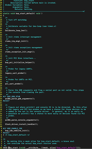

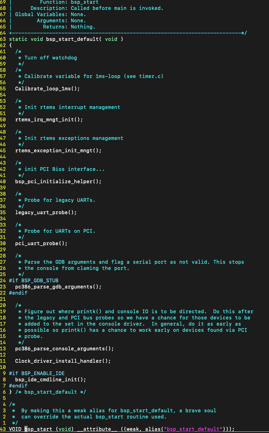

I also looked into the initialization path leading till bsp_start() where the hardware setup happens, so it seems this is where the non legacy changes would go into.

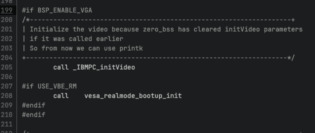

But before that in setup code (start.s), I find two calls - _IBMPC_initVideo and vesa_realmode_bootup_init both of which I have looked into are BIOS based and would need to be addressed.
As for _IBMPC_initVideo, which deals with early debugging, should we still continue to have VGA for legacy systems? or have UART here to replace it, how should this be supported
