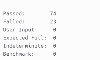

I compiled the testsuites for the configuration, SMP=true and DEBUG=TRUE/FALSE,
Before:

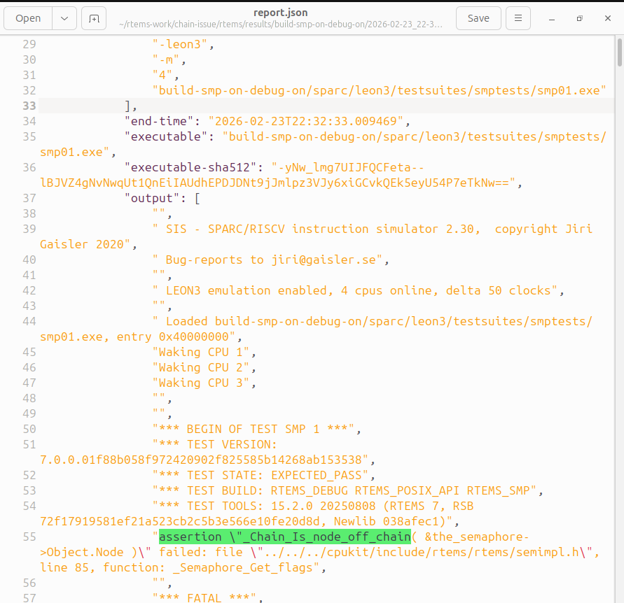

I generated the logs and checked for the first file which generated the bug,

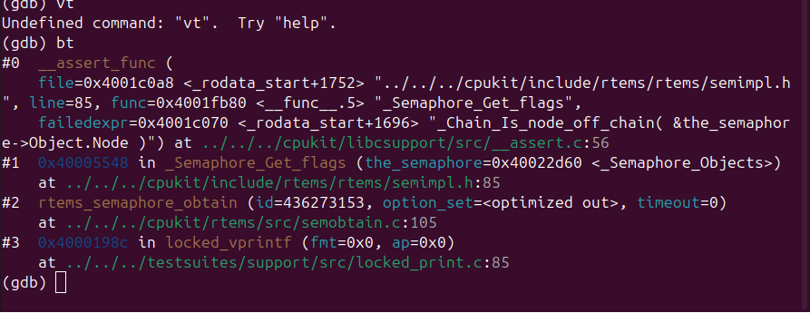

from this i ran the file using GDB to debug it, and got the function calls through back tracing which led to the assertion,

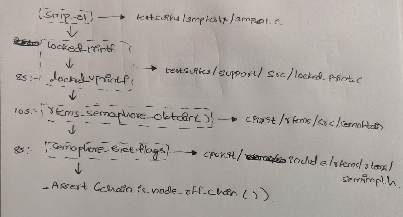

from this i looked into the relevant code files and understood the flow,
Clearly the smp01.c code tried to print something to the screen. To do this safely (so two CPUs don’t write over each other), it tried to grab a Semaphore.
So it wanted a free semaphore , and it called Semaphore_Get_flags which checks if the chain is free by _Chain_is_node_off_chain(), But semaphores store their flags in prev pointer, Since the _Chain_is_node_off_chain() got stricter in debug mode i.e asserts if prev!=null it was throwing error.

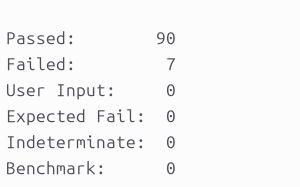

After:
The new failures are from new bug and are dealt seperately and will be documented seperately.
