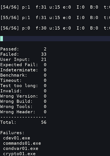

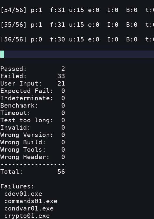

I was running the tests of rtems-libbsd-14 (rtems-7) for arm/xilinx_zynq_a9_qemu bsp like so:
$(RTEM_PATH)/bin/rtems-test --rtems-bsp=xilinx_zynq_a9_qemu build
And I’ve followed similar process described in RTEMS LibBSD Readme to build it.
Why most of the tests fails?
output.txt (12.3 KB)

After running all tests manually I noticed they all throws fails due to this assertion.
assertion "_Chain_Is_node_off_chain( the_node )" failed: file "../../../cpukit/include/rtems/score/chainimpl.h", line 678, function: _Chain_Append_unprotected
I realized that bug was fixed and my rtems source was outdated so I performed git pull.
Now only network related tests does not pass, they are mostly stuck and shows “Network is unreachable” or Timeouts after some time
