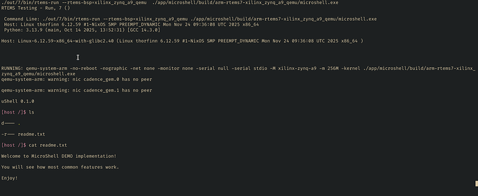

I was able to get microshell’s demo_linux example running for arm/xilinx_zynq_a9_qemu. Created an “external” task which sets up the terminal and then runs the non blocking service in a loop. I was wondering if there’s any documentation which outlines how libraries’ apis are laid out? an overview of some sort. Also I am assuming that the apis microshell would provide under rtems should be very similar to the default shell.
I suggest starting with RTEMS 6.2 Doxygen.
