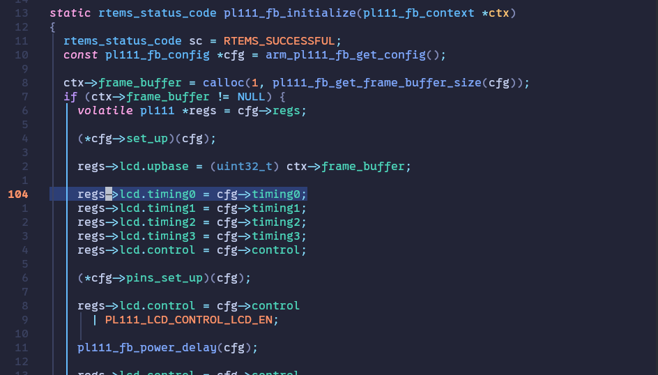

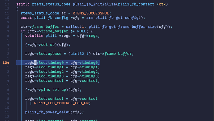

But still, I am facing the kernel crash. Based on my understanding, it is happening in the pl111_fb_initialize(…) function, where the pl111 register is getting updated. I have highlighted the place where the crash happened in the image below.
It seems to be the issue regarding the mmu.
I was able to solve the crash by changing the mmu sections in the bsps/arm/realview-pbx-a9/start/bspstarthooks.c, please find the patch below
