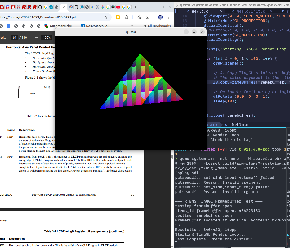

I was able to port the TinyGL 0.4.1, in the external application of arm/realview_pbx_a9_qemu bsp and able to create a simple GL app which produces the below result.

Thanks! I’m excited to move this forward. Here are the details regarding your questions:
  1. Changes to TinyGL: There were no major functional changes to the TinyGL core source. The primary work involved modifying the build system to exclude the GLX and X11-dependent files, focusing instead on the core rasterizer and RTEMS-compatible output.
  2. RSB Package: I am currently studying the RTEMS Source Builder (RSB) documentation. I definitely want to provide a proper recipe/package for this to ensure it integrates well with the ecosystem.
  3. Pointing Device Support: I plan to investigate the existing mouse data stream decoding in RTEMS. Integrating this with the TinyGL examples will be a priority so we can have interactive 3D demos.
  4. Documentation & Examples: I am currently in the process of cleaning up. I will share the source code, a working example (likely a simple rotating cube or gears demo), and the necessary documentation to reproduce the build as soon as the cleanup is complete.

Please find the zip file for the source code to execute the tinyGL demo here.
Requirements:
Bsps: arm/realview-pbx-a9
working build of the above bsps
Unzip the attached tinygl_arm_realview_pbx_ap_demo.zip file.
cd into the extracted folder
cd tinygl_arm_realview_pbx_ap_demo
./waf configure \
 --rtems=$HOME/quick-start/rtems/7 \
 --rtems-tools=$HOME/quick-start/rtems/7 \
 --rtems-bsp=arm/realview_pbx_a9_qemu
Use the command below for the execution
qemu-system-arm -net none   -M realview-pbx-a9 -m 256M   -kernel build/arm-rtems7-realview_pbx_a9_qemu/tinygl_demo.exe   -serial stdio   -display sdl
