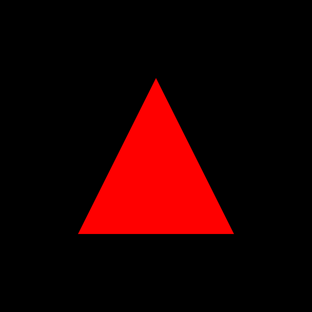

I’ve also adopted, built and ran hello_triangle app from PGL repo testing pool. Here the triangle is rendered on the screen.
Both can be found in repo here and tested.
