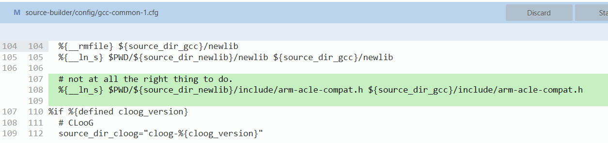

windows do not have real symlink like linux, you can modify gcc-common-1.cfg like this
