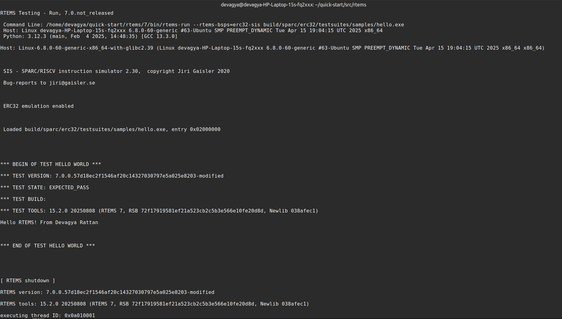

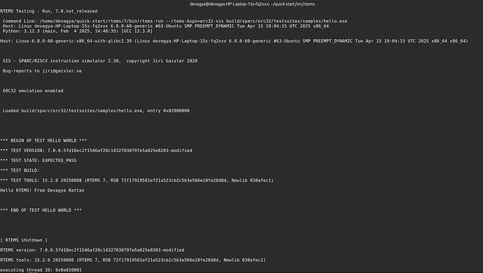

I have successfully completed the mandatory task:
  • Architecture: SPARC
  • BSP: erc32
Hello World Output:

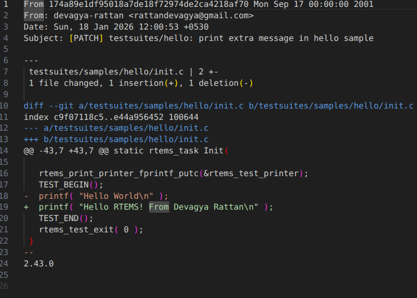

Patch Screenshot:

my updated Patch file
hi, it looks like your name is incorrect in your git config user.name. Please fix that, and you can add yourself to tracking/2026 · main · RTEMS / Programs / Google Summer of Code · GitLab
You can start a separate topic to discuss the MicroShell port project idea.
i need to add username for as per rtems gitlab username right?
No, you should provide a legal name as your git config user.name, this is how we track author attribution and confirm copyright.
