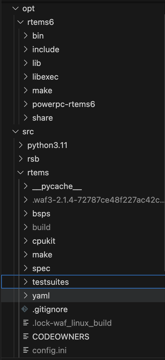

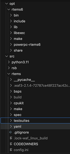

BTW, where is the tester\rtems\testing\bsp folder located? Is it in the src tree or in the install folders? Here is an image of the folders I have!
That path is the source location in rtems-tools. It is also installed as part of the tools install process. Most of the tester confguration information you need can be found here: 11.4. Tester Configuration — RTEMS User Manual 7.491f6c8 (12th May 2025) documentation

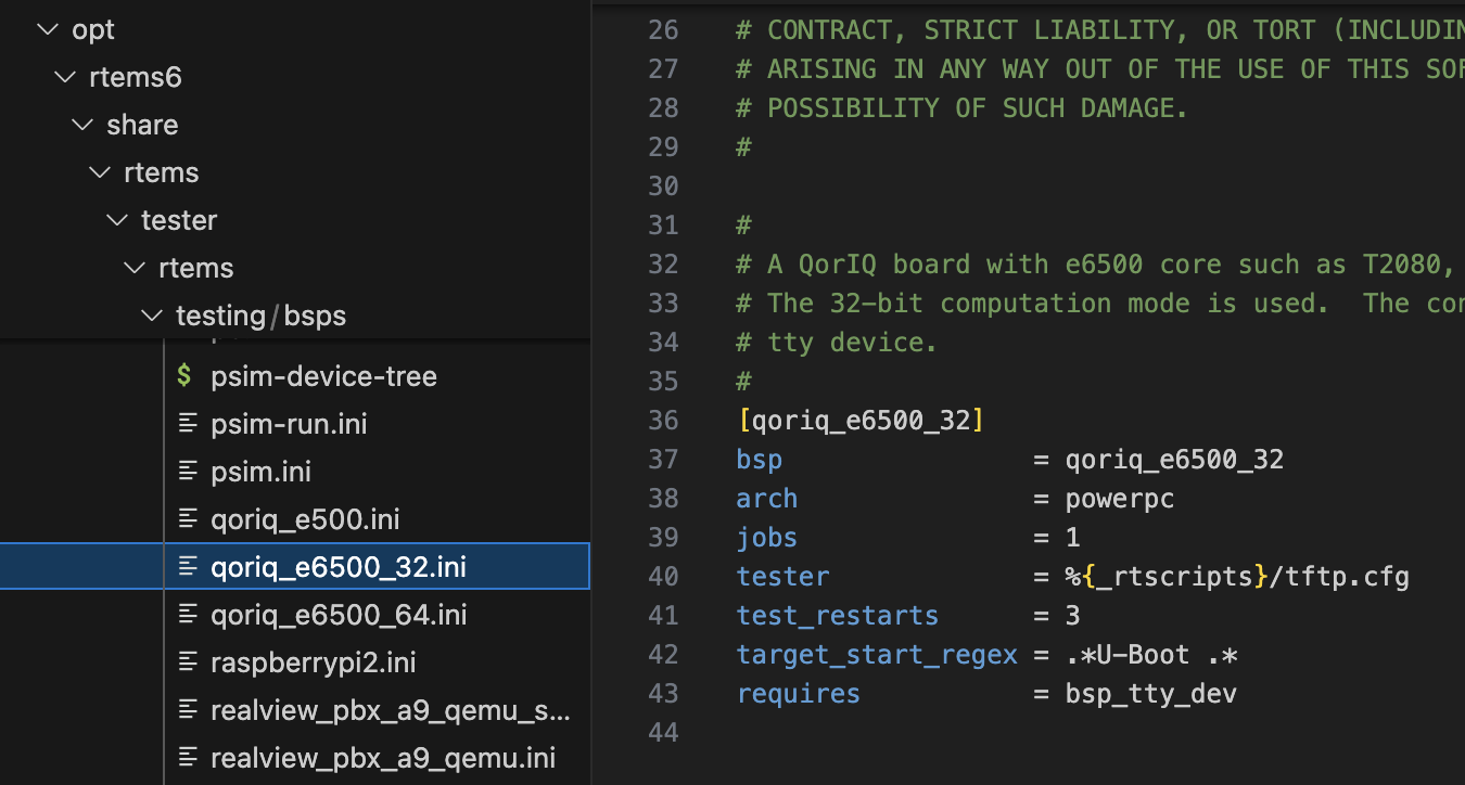

OK. I’ve found the .ini file, shown in the pic! And thanks for the link to the document. I’ll go through it to understand how it works.
Now, what does requires = bsp_tty_dev mean. Does it mean it requires a commandline or an environment parameter named bsp_tty_dev or is it the name of some other module etc?
That variable must be provided by the user. This is typically done in user-config.ini. Please see the link I referenced.
