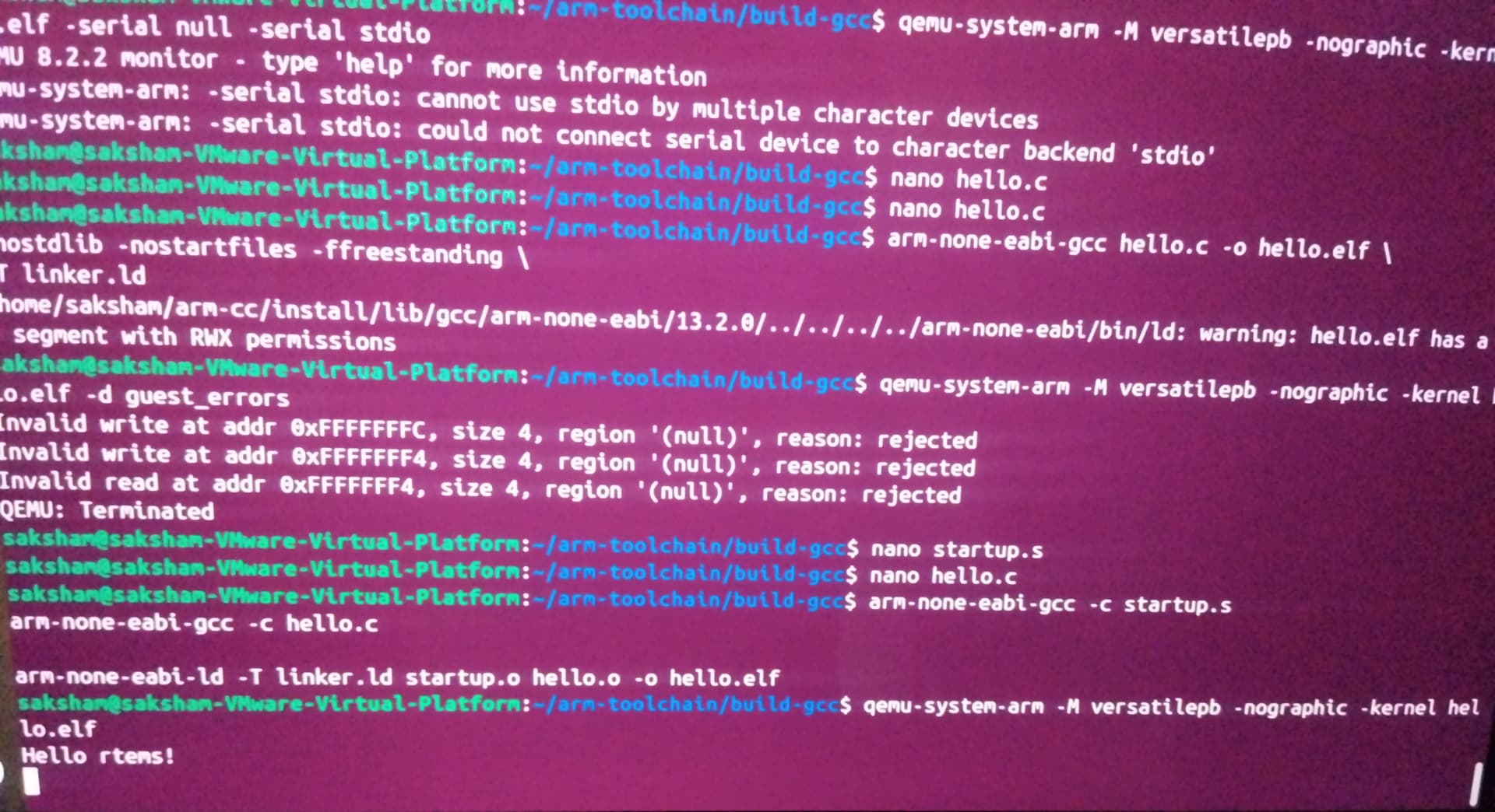

I have successfully built an ARM cross-compilation toolchain from source and tested it by running a simple bare-metal program on QEMU.
Project Overview:
Built ARM toolchain (arm-none-eabi-gcc)
Created a minimal bare-metal setup using:
startup.s
linker.ld
hello.c
Compiled and linked the program without standard libraries (freestanding environment)
Executed the ELF binary using QEMU (versatilepb machine)
Output: The program successfully ran and printed: “Hello rtems!”
