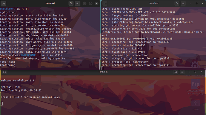

I made and run the Hello world Program with documentation and load the build with the instruction as mention in the stm32f7 section since stm32f4 section is in todo but, i am not able to see the printf output on the minicom.
i don’t have JTAG and I using on board debugger.

I checked on every know baud rate. But the output was only garbage. I opened the Arduino IDE and check the uart on every baud rate. It is showing garbage.
