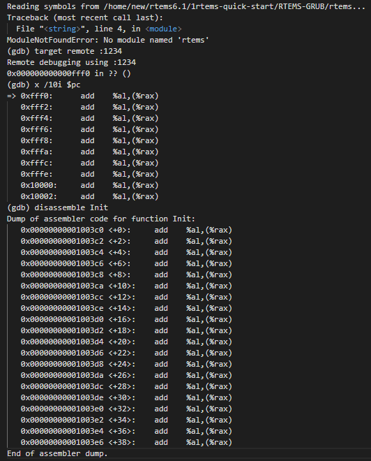

No output after startup, no response, so I tried to view it through QEMU’s GDB mode.
Debug
qemu-system-x86_64 -no-reboot -nographic -m 256M -bios OVMF.fd -drive file=RTEMS-GRUB.img,format=raw,media=disk -serial mon:stdio -s -S
gdb-multiarch .../RTEMS-GRUB/rtems
I found that all the assembly instructions inside are add:
I don’t know which step went wrong, thank you for your help.
