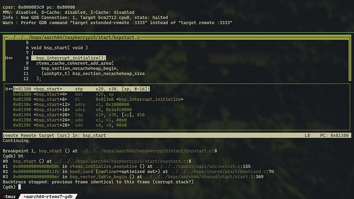

    Status - I got to bsp_start but got stuck there due to what I believe a bad heap section in the linker script when it tries to map the heap in rtems_cache_coherent_add_area.
Details and further updates, I will post in the dedicated post for the contribution.
