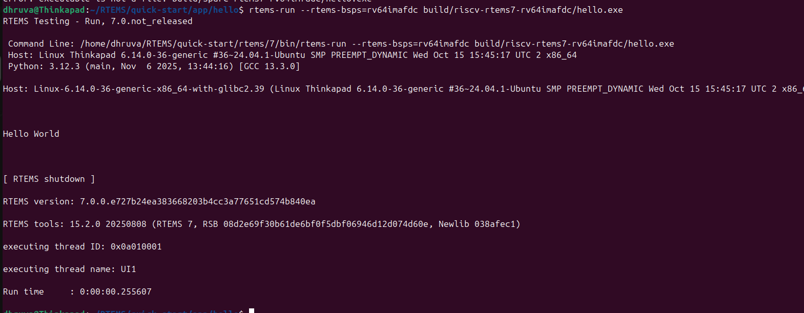

Proof of Work
  • Architecture: RISC-V
  • BSP: rv64imafdc
